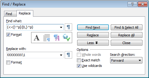

You can use the following regular expression in the "Find what" box:
(<<[!^p]{0,}^p)
Then select the required paragraph format.
Then use the following "Replace with" pattern:
XXXXX\1
XXXXX should be replaced with the characters that you want to insert.
The "Use wildcards" option should be checked.
(<<[!^p]{0,}^p)
XXXXX\1
- find_replace.png (12.39 KiB) Viewed 4623 times
Thank you Robert, that trick with the empty box worked perfectly. I will have to remember that for future use.
